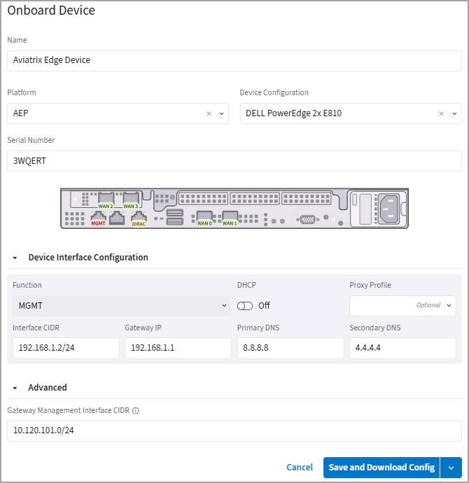

  1. In Aviatrix CoPilot, go to Cloud Fabric > Hybrid Cloud > Devices tab.
  2. Click Onboard Device, then provide the following information.
    Field
    Description
    Name
    A name to identify the edge device.
    Platform
    The Aviatrix Edge Platform Account where to onboard the device.
    Device Configuration
    Dell HW with single ethernet controller for Edge Spoke Gateway, select:
    • DELL Poweredge 1x E810
    Dell HW with two ethernet controller for Edge Spoke or Transit Gateway, select:
    • DELL Poweredge 2x E810
    Serial Number
    The serial number of the edge device.
  3. Expand Device Interface Configuration and configure the device’s Function MGMT (Management) interface.
    1. If you plan to use DHCP for the device Management interface, turn DHCP toggle to On.
    2. If you plan to configure a Static IP address for the device Management interface, leave DHCP toggle to Off.
    3. If DHCP is Off, enter the Static IP address for the Management interface.

    4. If you are using a proxy server to route internet traffic, from Proxy Profile dropdown menu, select the profile to upload to the edge device.
  4. Under Advanced, specify the Edge Management CIDR that will be used on the Edge Gateway interface. If a CIDR is not specified, the system auto assigns 10.100.101.0/24 CIDR range and assigns 10.100.101.2 IP on the interface.
    If the auto assigned CIDR is used, ensure that this range does not overlap with any other network.
    500
  5. Save the configuration.

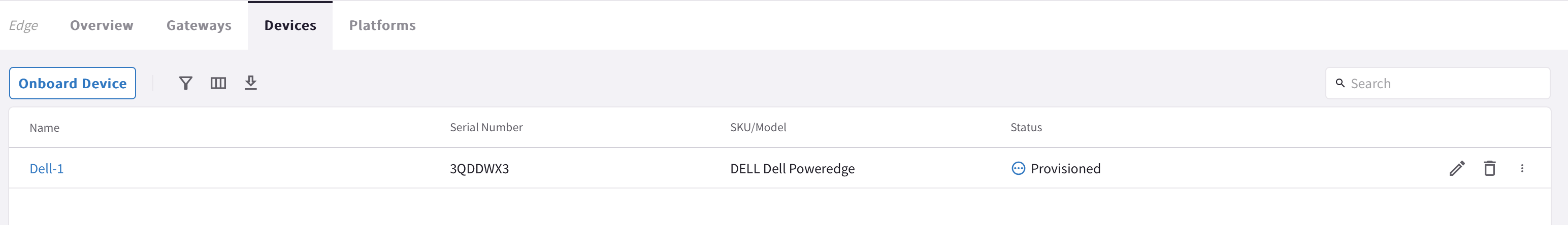

    • When DHCP is selected for MGMT interface, click Save.
    • When Static IP is selected for MGMT interface, from the Save and Download Config drop-down menu, click Save.
      This will download a bootstrap-config.img file (for example, 3QDDWX3-bootstrap-config.img). Your device will show up as Provisioned in Copilot.

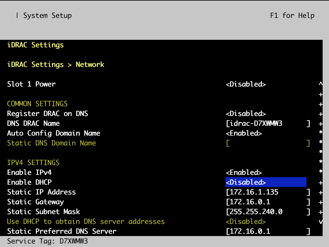

  2. From the Dell server’s VGA/serial console, from iDRAC Settings > Network to setup iDRAC with Static IP address or desired IP address settings, apply the new settings and then reboot the system.

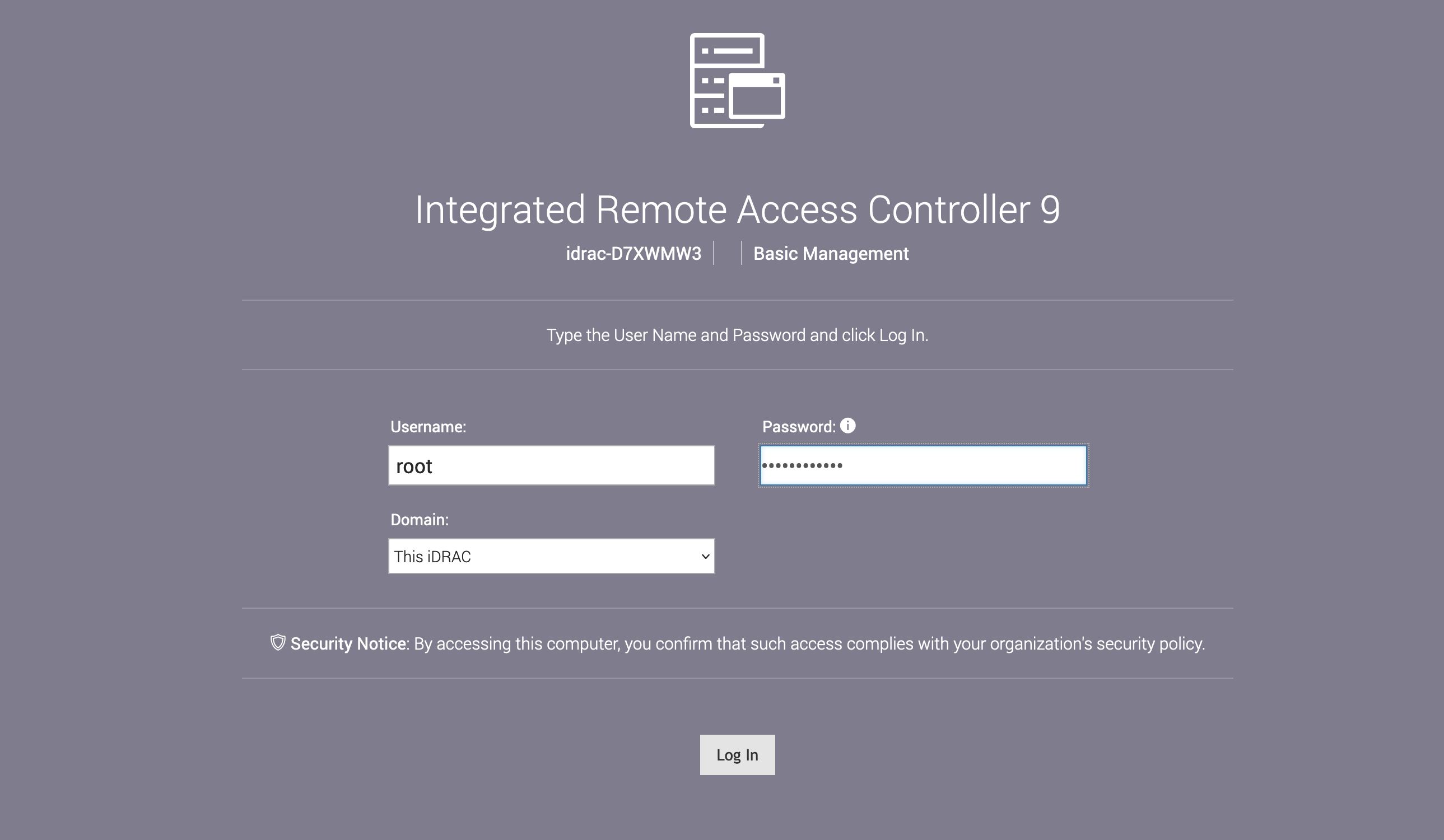

  3. Identify the Dell server’s face panel with dual USB ports and plug in Aviatrix OS installer USB disk to the USB port labeled with SS; then browse to iDRAC’s IP address to login to the iDRAC UI with default credentials, which can be found from the Dell service tag label.
    Do not reset the root password when prompted to do so.

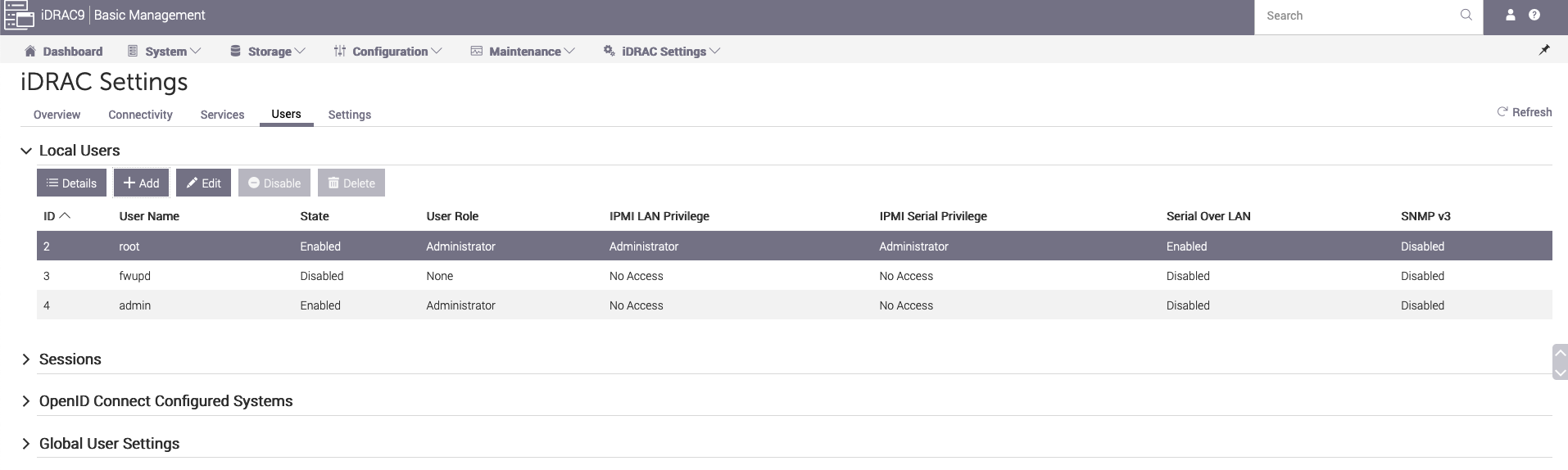

  4. After you login to iDRAC UI, go to IDRAC Settings > Users add a default login user account.

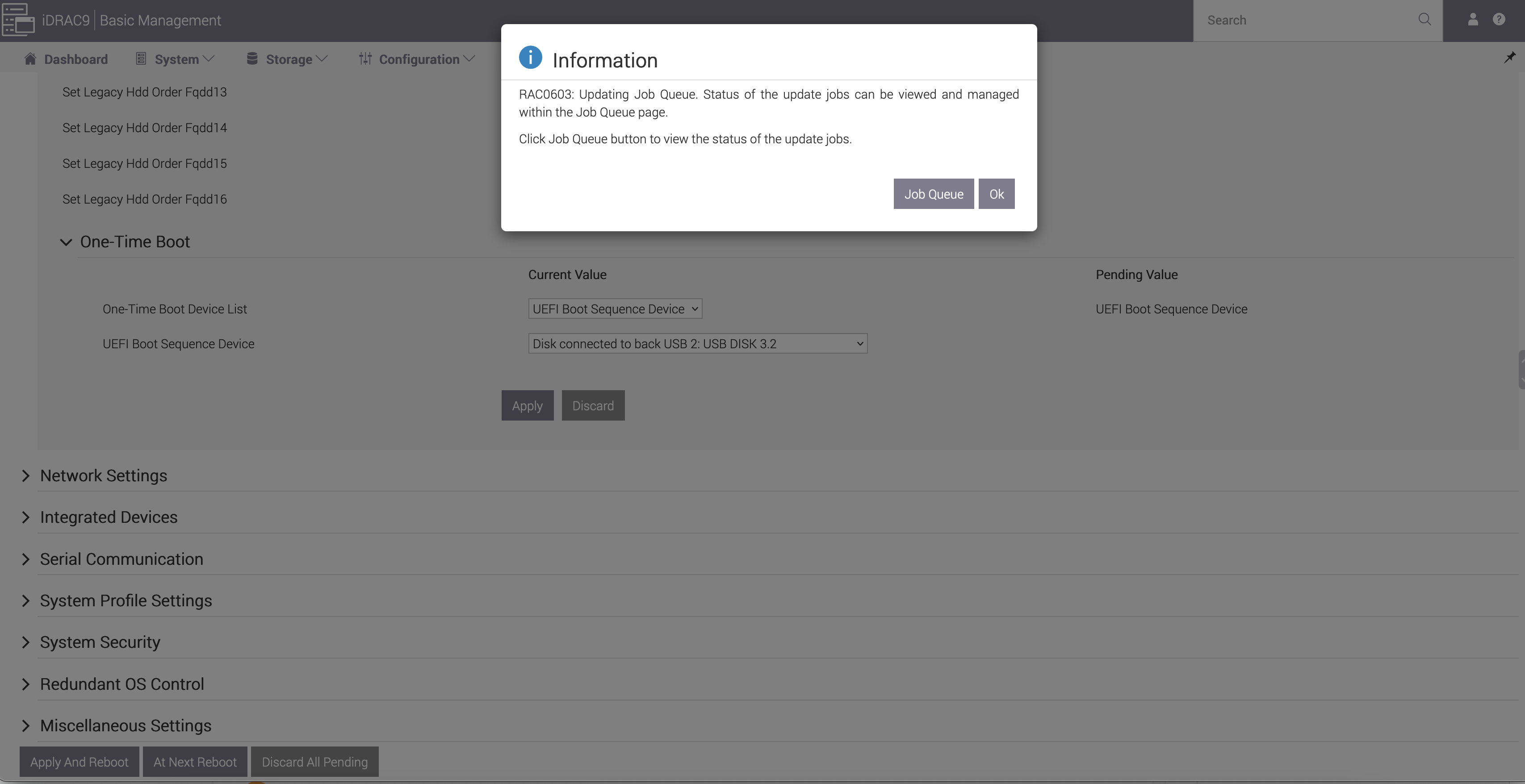

  5. From iDRAC9 UI Configuration > BIOS Settings, follow Aviatrix’s recommended BIOS configuration in Dell PowerEdge BIOS Configuration.
    Apply BIOS setting changes, go to the bottom of the page and click Apply AND Reboot and OK.

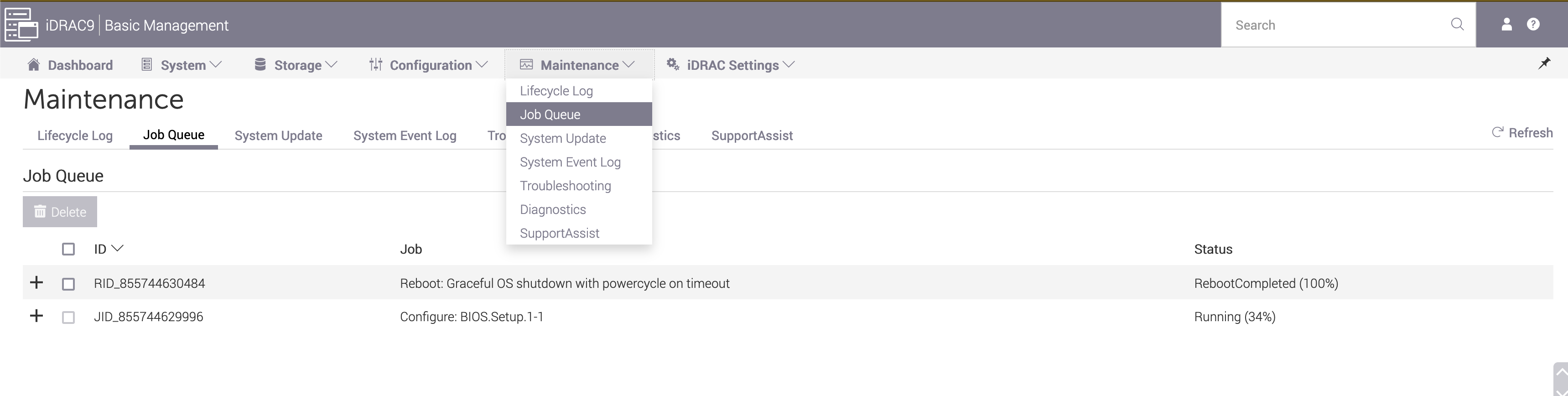

  6. Go to Maintenance > Job Queue, you can see current Job queue and task status.

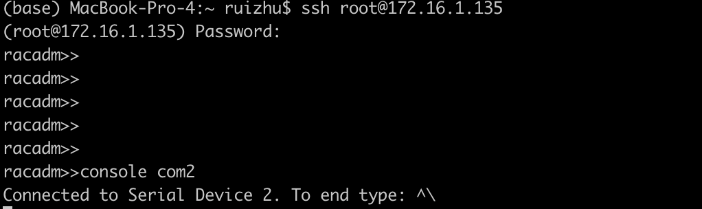

  7. Login to iDRAC9 console using SSH.
    ssh admin@idrac9_mgmt_ip
    and issue the following command to enter Eve device console:
    console com2
    500

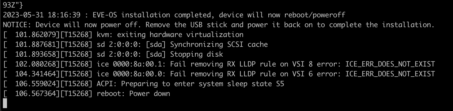

    Wait 5 to 10 minutes until the installation is done and you should see the log below log from iDRAC9 console.
    500

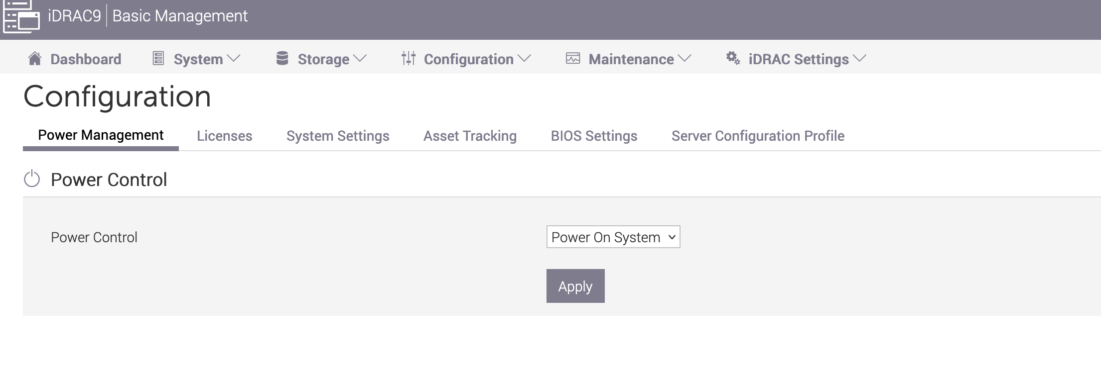

  8. Detach the USB installer from the Dell R450 and power it on from Configuration > Power Management, from Power Control dropdown, choose Power On System and click Apply.
    500
    Wait 5 to 10 minutes while Aviatrix OS boots up.
  9. The device will power off once the installation is done. At this stage, connect the USB drive which has the static IP information to the device and power on the device. Aviatrix Edge OS will read the static IP information from the USB and configure the device. To view the configuration logs, you can SSH to the device and connect to the serial console.
