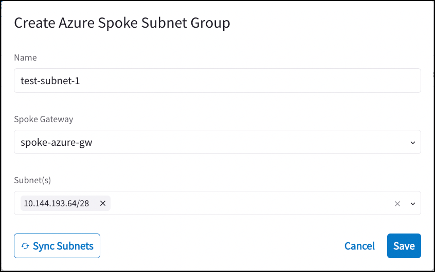

When you add an Azure Spoke subnet group, selecting the Spoke Gateway automatically synchronizes the Subnet(s) list with the Azure portal so that the list is refreshed with any new subnets for this Spoke Gateway.

Add a Subnet Group
If adding a subnet group, click +Azure Spoke Subnet Group.
Enter a name for the Subnet Group.
Select the Spoke Gateway (only Spoke Gateways attached to this Transit FireNet are available). The Subnet(s) list is automatically refreshed with any new subnets for this Spoke Gateway from the Azure portal.
Select the Subnet Group(s).
Click Save. It may take a couple of minutes for the changes to save.
After the changes are saved, click Close to close the Create Azure Spoke Subnet Group dialog.
The new subnet group is displayed on the Azure Spoke Subnet Groups dialog.

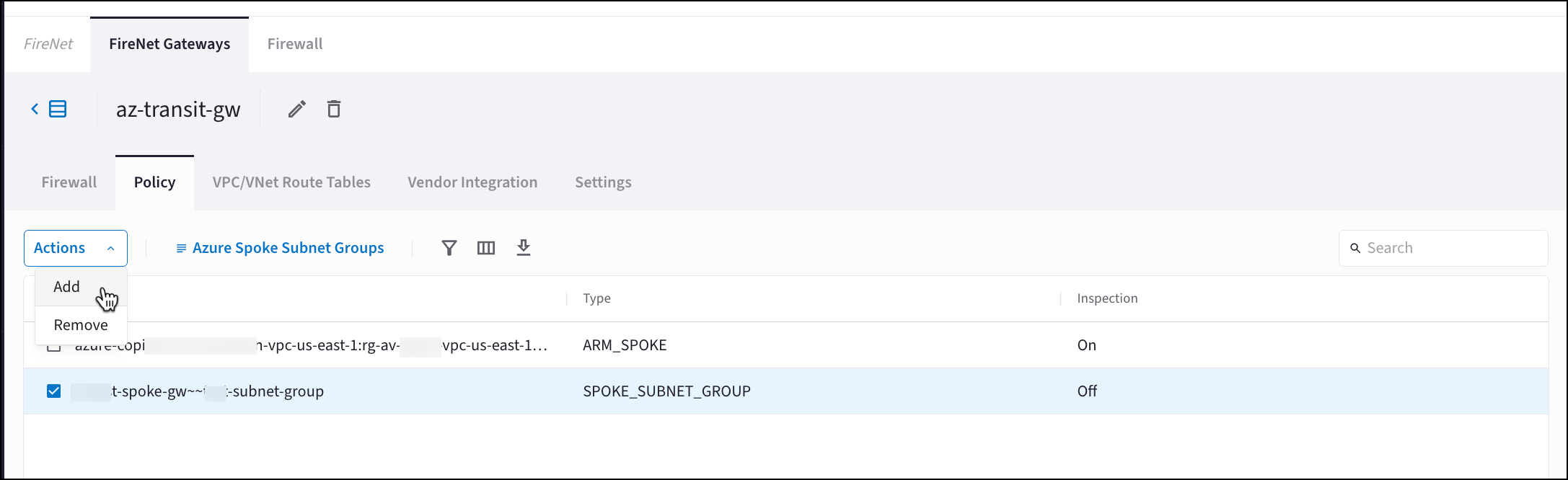

Adding Inspection Policy for Spoke Subnet Group
After your new subnet groups are created, you can add them to the inspection policy for this particular Azure Transit FireNet gateway.
Select the Spoke Subnet Group in the Policy list.
Click Add in the Actions list.
See Configuring Transit FireNet Inspection Policies for more information.
Removing Spoke Subnet Groups
Disable inspection for the Spoke Subnet Group by selecting the group on the FireNet Gateways > Policy tab and then selecting Remove from the Actions menu.
