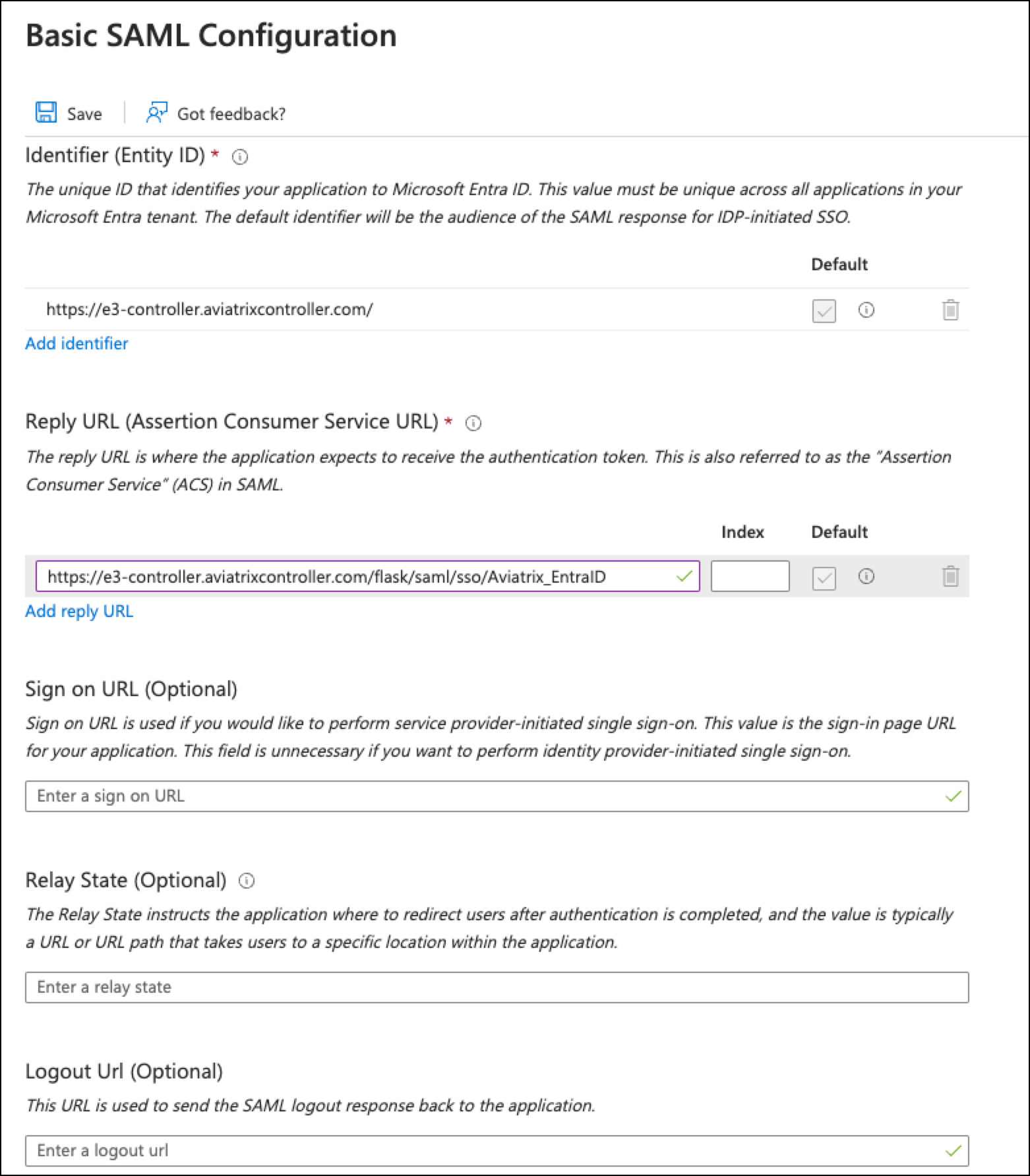

  9. On the SAML-based Sign-on page, click Edit next to Basic SAML Configuration. The Basic SAML Configuration page displays.
    saml intraid config4
  10. Enter the following information:
    • Identifer (Entity ID): paste the URL of your Controller. If you have additional Controllers, you can add additional identifiers (and configure SAML on the associated CoPilot instance).
    • Reply URL (Assertion Consumer Service URL) field: paste the recently copied Assertion Consumer Service URL that became available after creating the SAML endpoint in CoPilot.
    • The other fields are optional.
For the Entity ID and the Reply URL, enter both the hostname and the IP address.

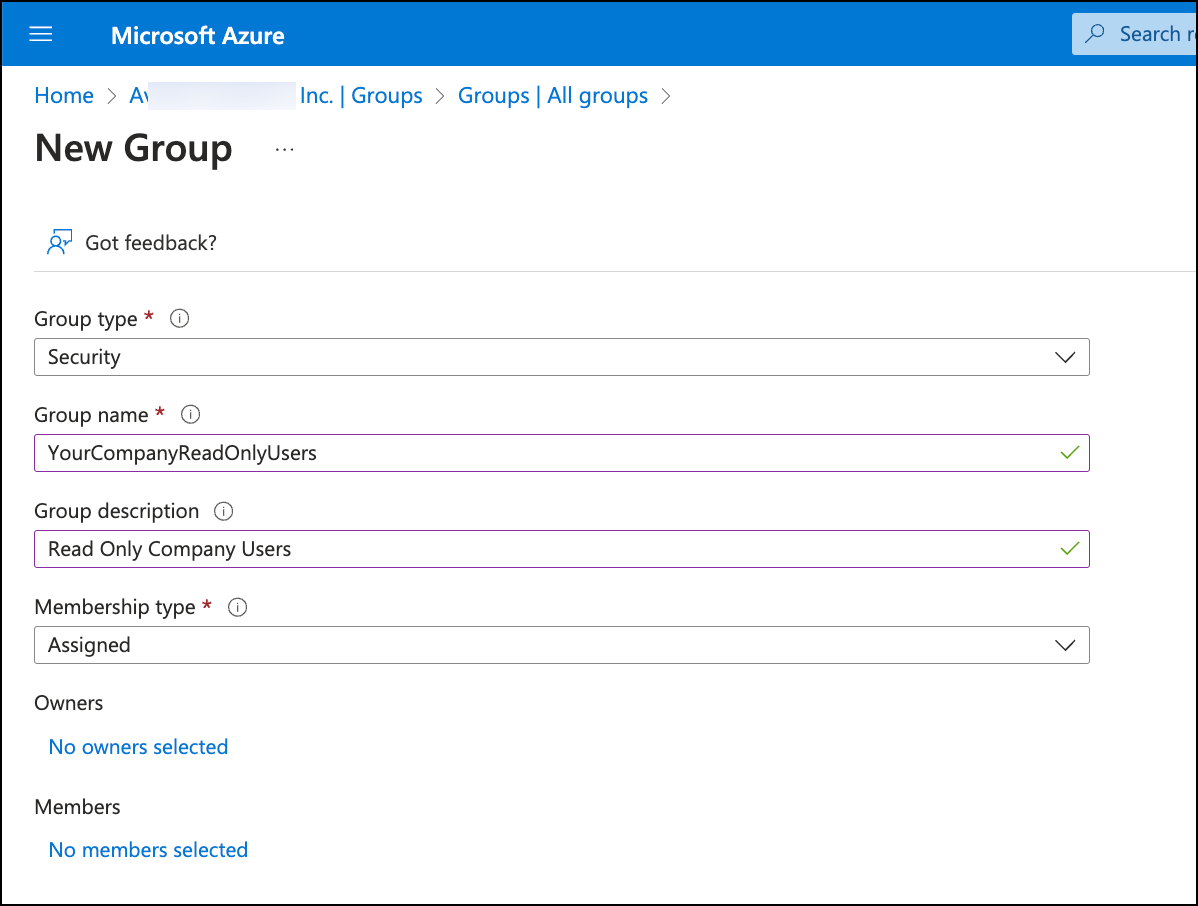

Adding Users and Groups

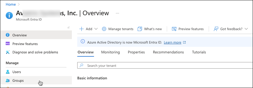

If you have not already done so, create the necessary groups and users for SAML access. Aviatrix recommends creating the following groups: AviatrixAdmins, AviatrixUsers, AviatrixReadOnlyUsers, and AviatrixSecOPs.
  1. Add groups from the Entra ID main menu by selecting Groups (as shown below).
600

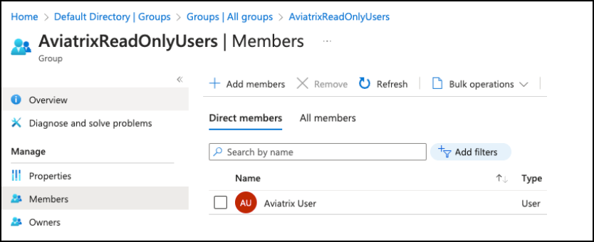

  1. On the All groups page, click New Group to create groups that meet your access requirements.
400
  1. After the groups are created, add users to the groups.

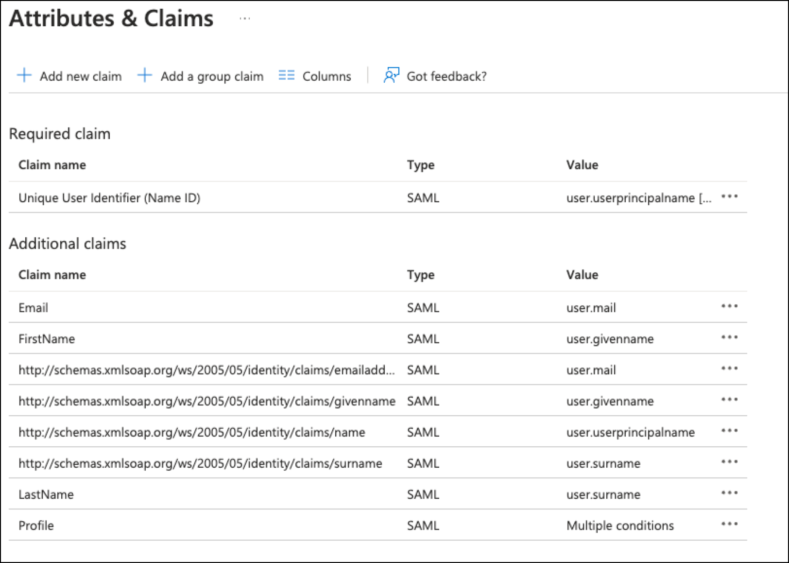

  1. Next, on the Enterprise application Overview page, click Set up single sign-on and configure Attributes & Claims.
  2. Click Add new claim.
    saml intraid config
  3. Add new claims for the following as per the above screenshot (using the values shown above):
    • Email
    • First Name
    • Last Name
    • Profile

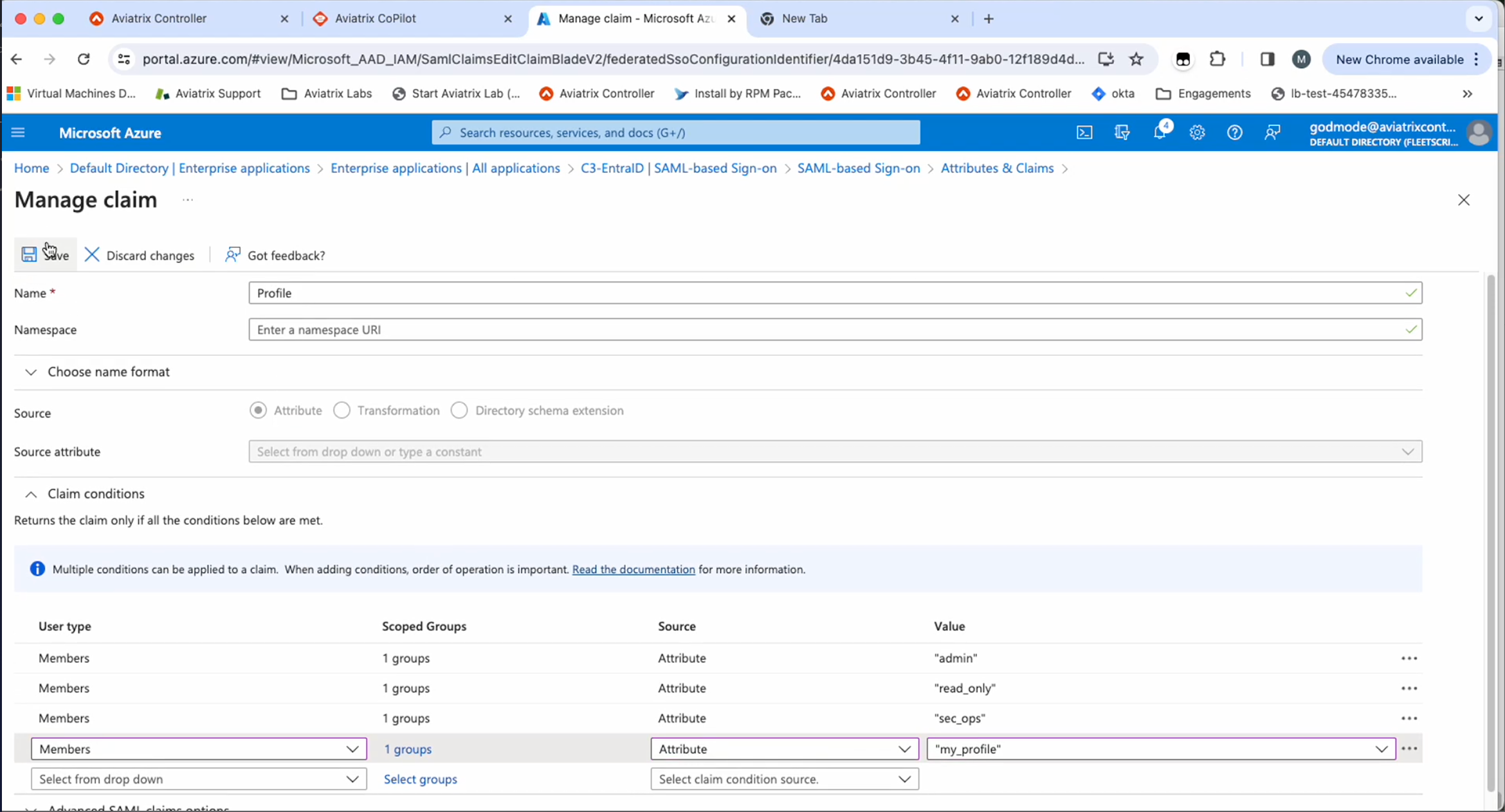

  4. In the Profile claim, add conditions similar to the folloiwng for the user groups you created (the below is for example purposes only).
    User Type Scoped Groups Source Value
    Members
    AviatrixAdmins
    Attribute
    admin
    Members
    Attribute
    read_only
    Members
    AviatrixSecOPs
    Attribute
    sec_ops
    Members
    AviatrixUsers
    Attribute
    my_profile
    saml intraid config2
  5. Once you have configured all necessary groups, save the claim configuration.

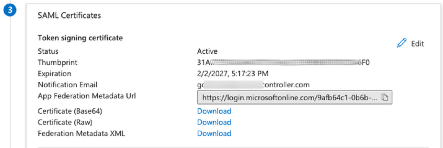

  1. Return to the Entra ID Overview page and copy the App Federation Metadata URL.
saml intraid config3
  1. In CoPilot, click the Edit edit icon icon for the SAML endpoint you created.
  2. Paste the copied metadata into the URL field.
  3. Click Save.
