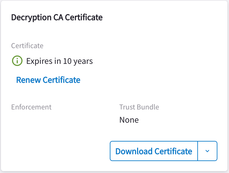

Downloading the Aviatrix Certificate
You can download the currently applied Aviatrix CA certificate and add it to your trust bundle.
To download the CA certificate provided by Aviatrix:
Navigate to Security > Distributed Cloud Firewall > Settings.
On the Decryption Trust CA Certificate card, click Download Certificate.
![300](_images/dfw-ca-cert.png)
Ensure that the downloaded file is saved to the appropriate location on your computer, and any client machines involved in your Distributed Cloud Firewall configuration.
Renewing Your Certificate
You must renew your Aviatrix CA certificate when it is about to expire.
When you click Renew Certificate, the certificate renews automatically.
You can also upload your own CA certificate.
