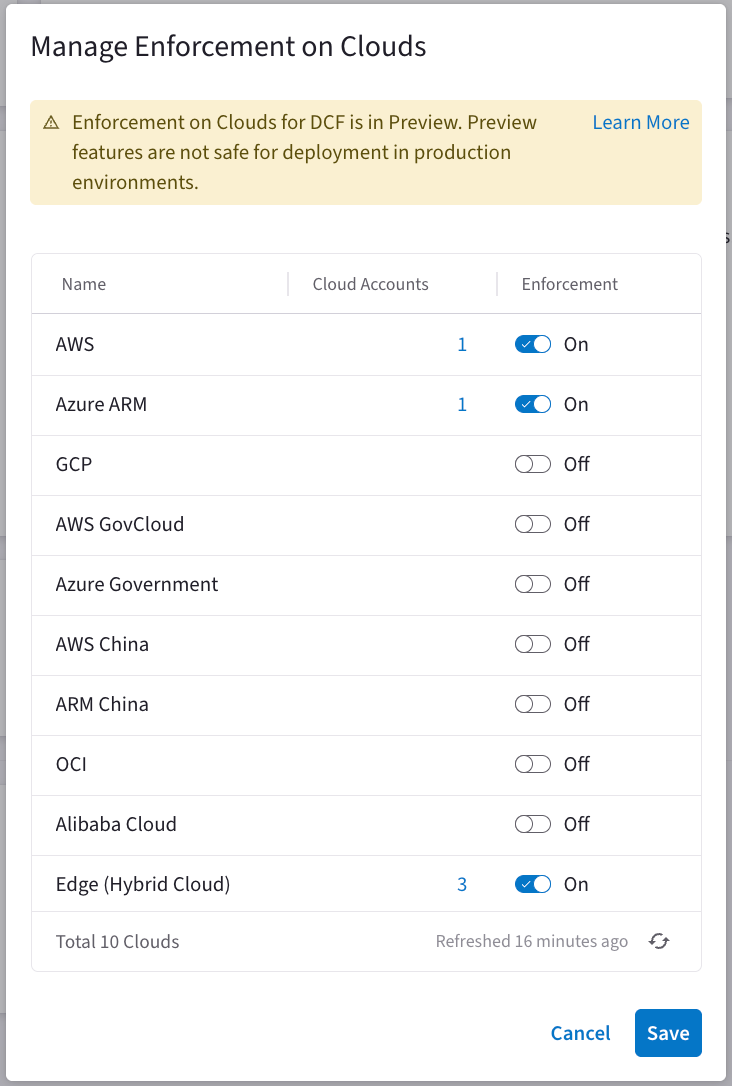

Enforcement on Clouds
If using Controller 8.1, you can control the enforcement of Distributed Cloud Firewall (DCF) rules on various clouds.
| If using Controller 8.0 or lower, DCF is enabled by default on these clouds: AWS, AWS GovCloud, Azure, Azure Government, and GCP. |
After the DCF feature is enabled, DCF rules are enforced for any clouds that have enforcement turned On.
Managing Enforcement on Clouds
Click Manage on the Manage Enforcement on Clouds card under Security > Distributed Cloud Firewall > Settings to enable or disable enforcement of DCF rules on various clouds. You must have Enforcement turned On for at least one cloud to save your changes.
After selecting which clouds will enforce DCF rules, click Save.
If you turn off enforcement for a cloud, you are prompted to select a checkbox confirming that you understand DCF protection will be disabled on that cloud. You then click Disable.

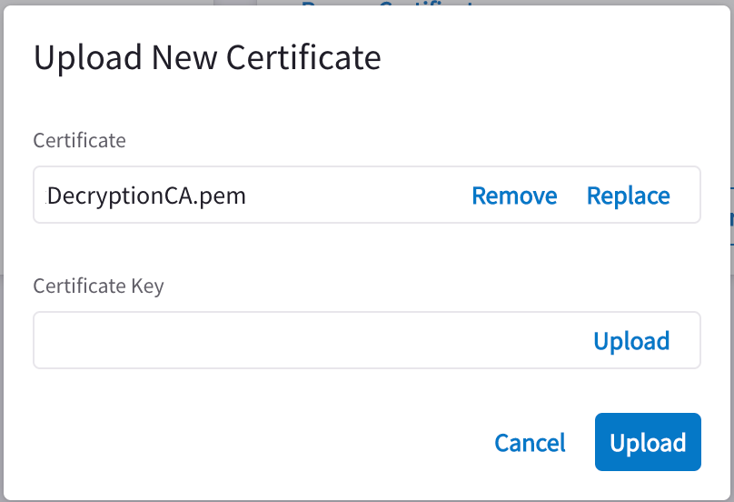

Uploading Your Own Certificate
It is best to upload your own certificate (must be in .pem format), since you likely have this certificate in use throughout your environment. You can remove the default Aviatrix CA certificate first, if desired.
On the Settings tab, on the Decryption CA Certificate card, click the arrow next to Download Certificate and click Upload New Certificate.
In the Upload New Certificate dialog, you can upload, remove or replace a certificate and its corresponding certificate key.
Both fields must be populated. Click Upload.

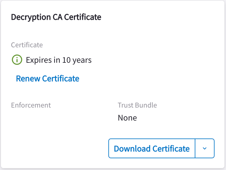

Renewing Your Certificate
You must renew your Aviatrix CA certificate when it is about to expire.
When you click Renew Certificate, the certificate renews automatically.
You can also upload your own CA certificate.
