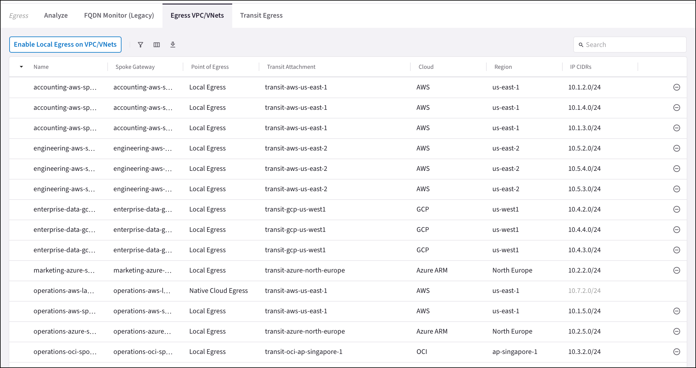

Enabling Local Egress
On the Security > Egress > Egress VPC/VNets tab you can enable Local Egress on selected Spoke VPC/VNets that do not already have Egress enabled, and that are not attached to a Transit FireNet gateway.
egress vpc vnets tab

  2. On the Security > Egress > Egress VPC/VNets tab, do one of the following:
    • Select one or more VPC/VNets and then select Enable Local Egress from the Actions menu.
    • Click the vertical ellipsis next to a VPC/VNet and select Enable Local Egress.

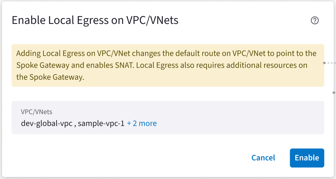

      The Enable Local Egress on VPC (VNets) dialog displays.
300
  1. Click Enable to acknowledge that enabling local egress changes the default route and enables SNAT.
