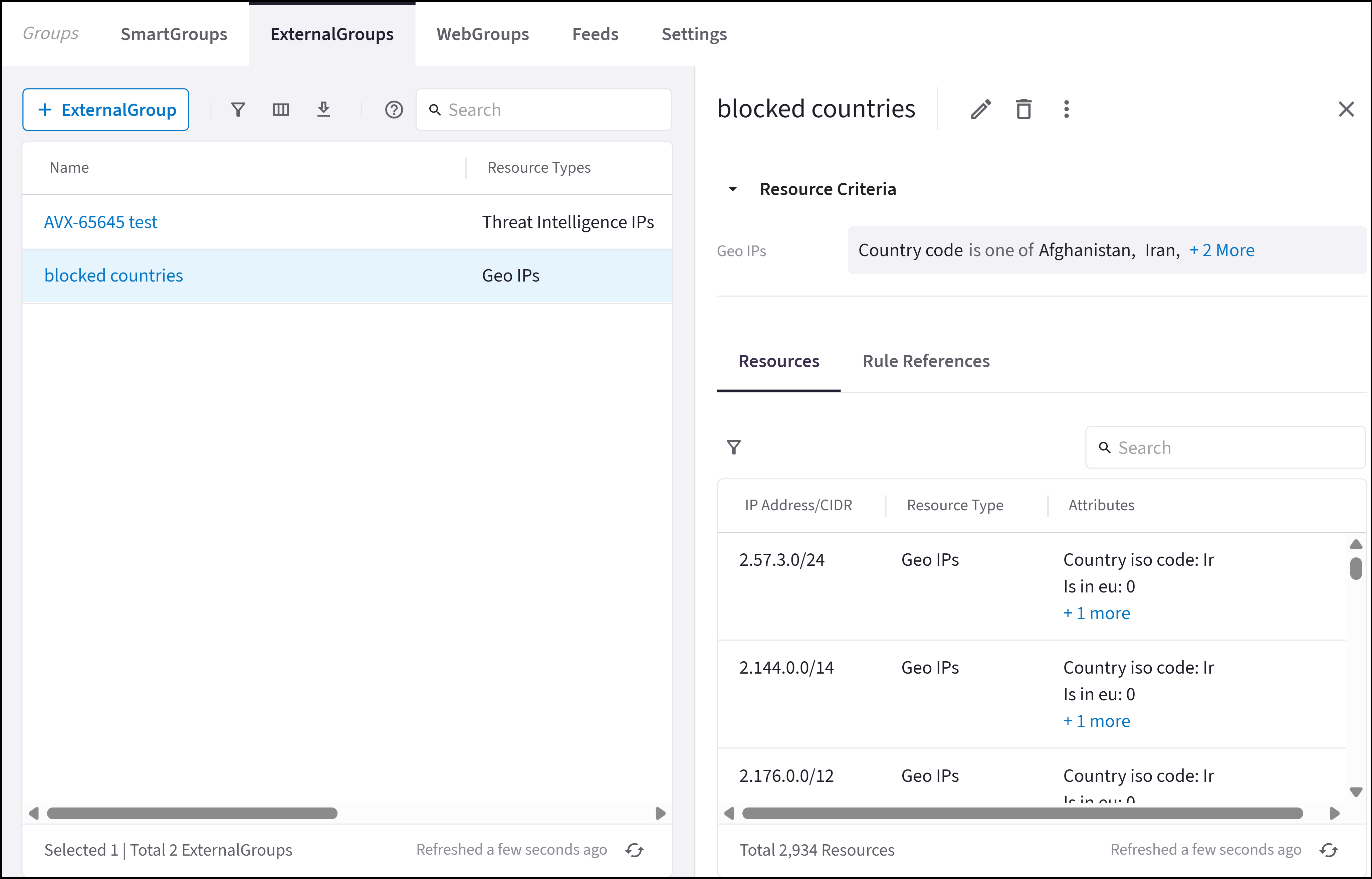

Viewing ExternalGroup Details
On the ExternalGroups tab, click one of the sub-categories (ExternalGroups, Threat Feeds, Countries) and then an item in the list to see its details.
